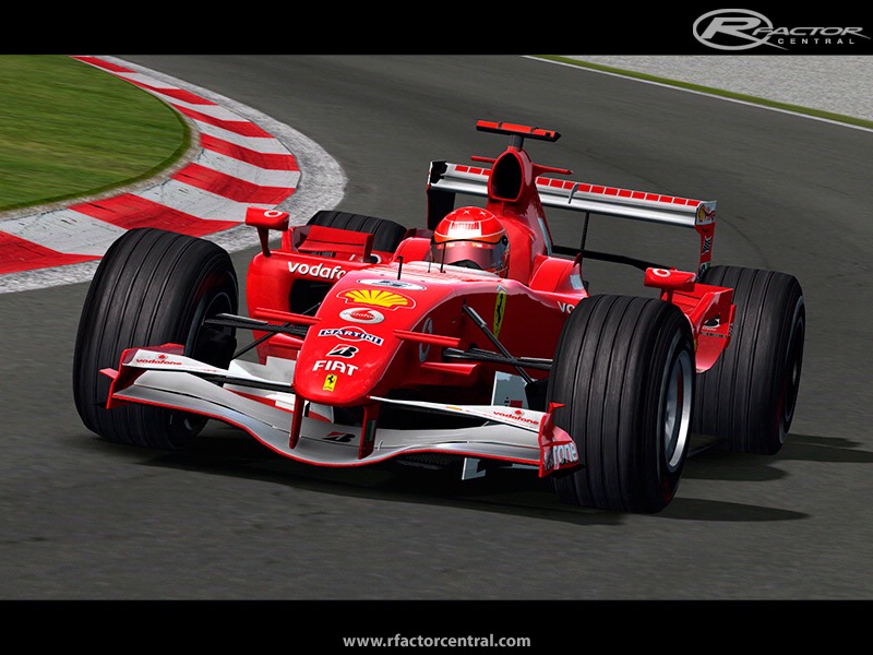

V1.0 by GSMF-Alien & 6e66o
Cubemaps @ RFC
